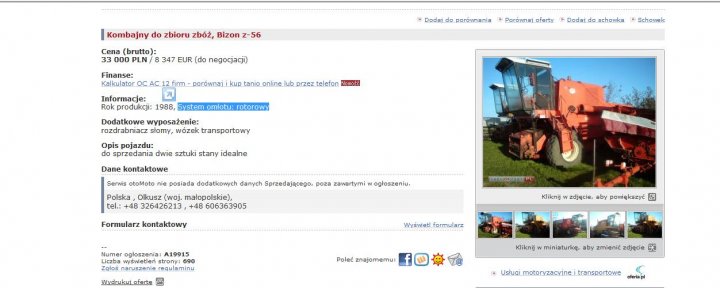

      https://m.olx.pl/oferta/bizon-zo56-CID757-IDyYR2O.html?backUrl=%2Fajax%2Fmojolx%2Fdetails%2F516899010%2F
