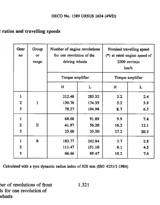

Pewnie tyle co Ursusa 1614    1 II - 9,934   1II WZ- 7,426
