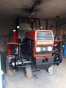

  6. pat12045
    Zetor 12045
    Film z remontu
