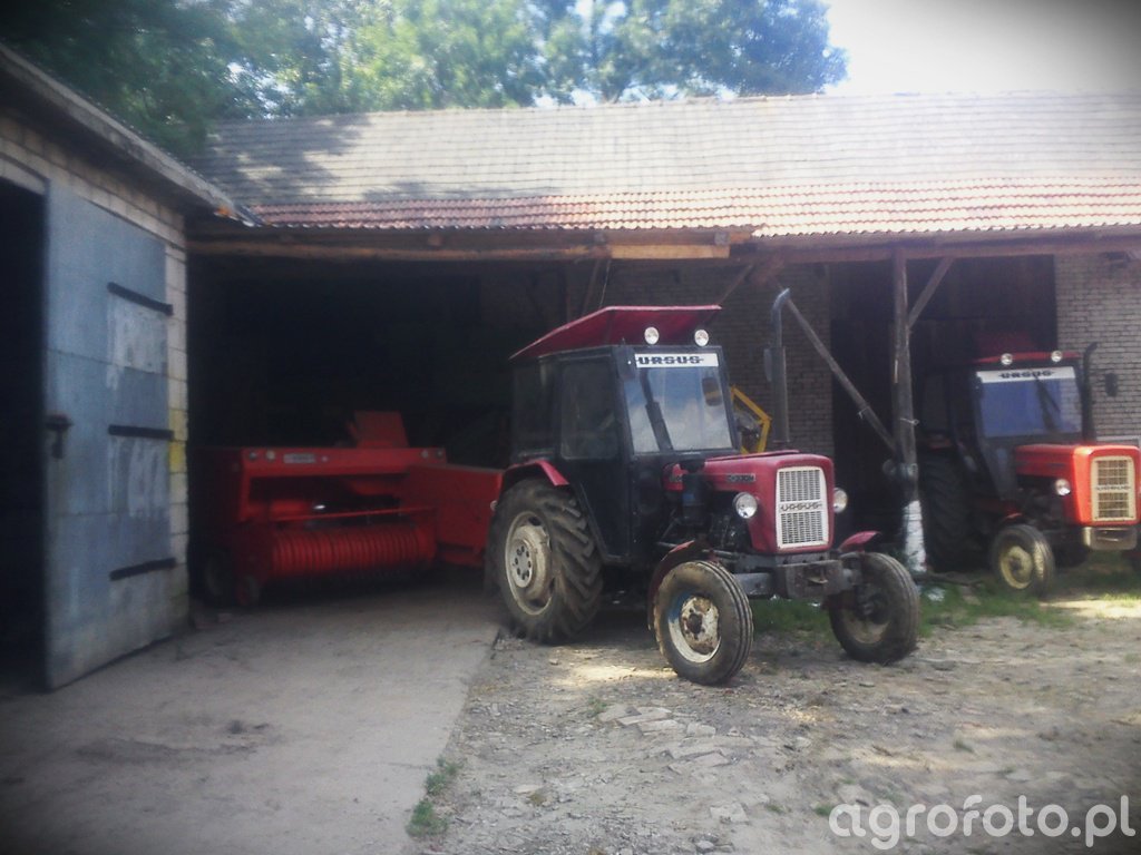

Ursus C-330M + Sipma Z-224/1 & Ursus C-360
