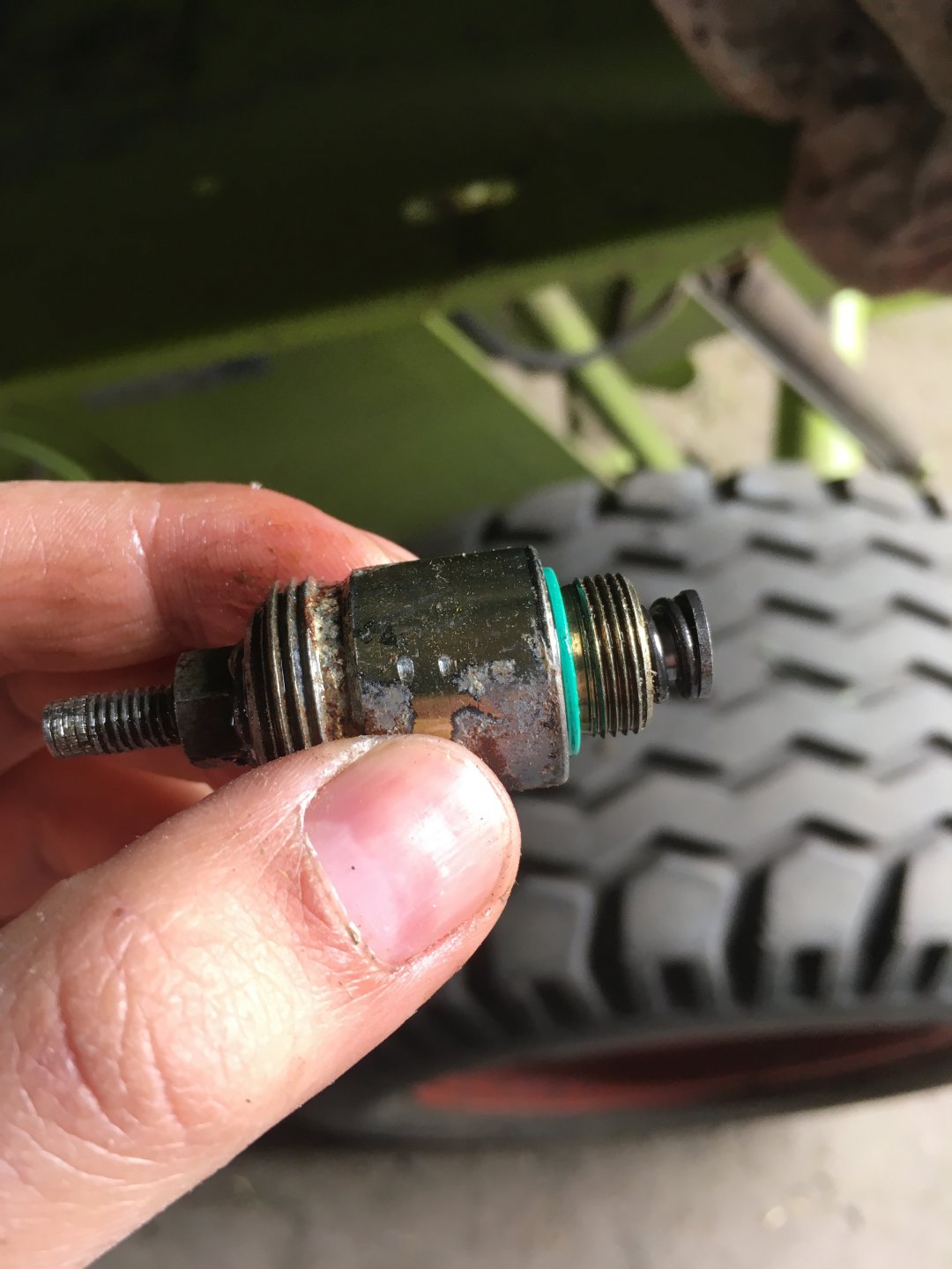

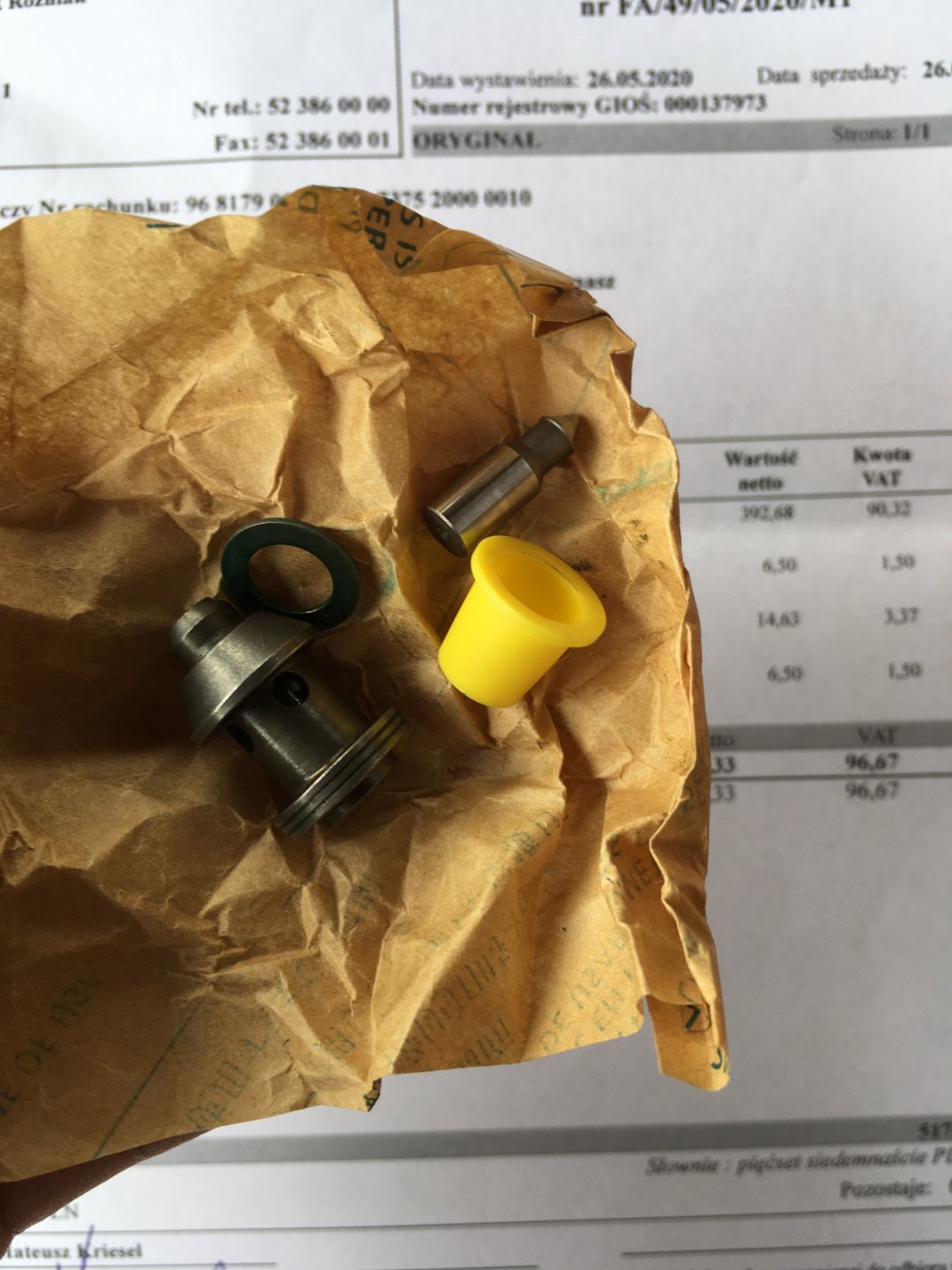

  3. 2054 Napięcie odniesienia 5 V za niskie.2054 Za niskie napięcie odniesienia 5 V. https://www.justanswer.com/agriculture-and-farm-equipment/g3jwu-ts-135a-tractor-show-2054-fault-code-hade-dealer.html
