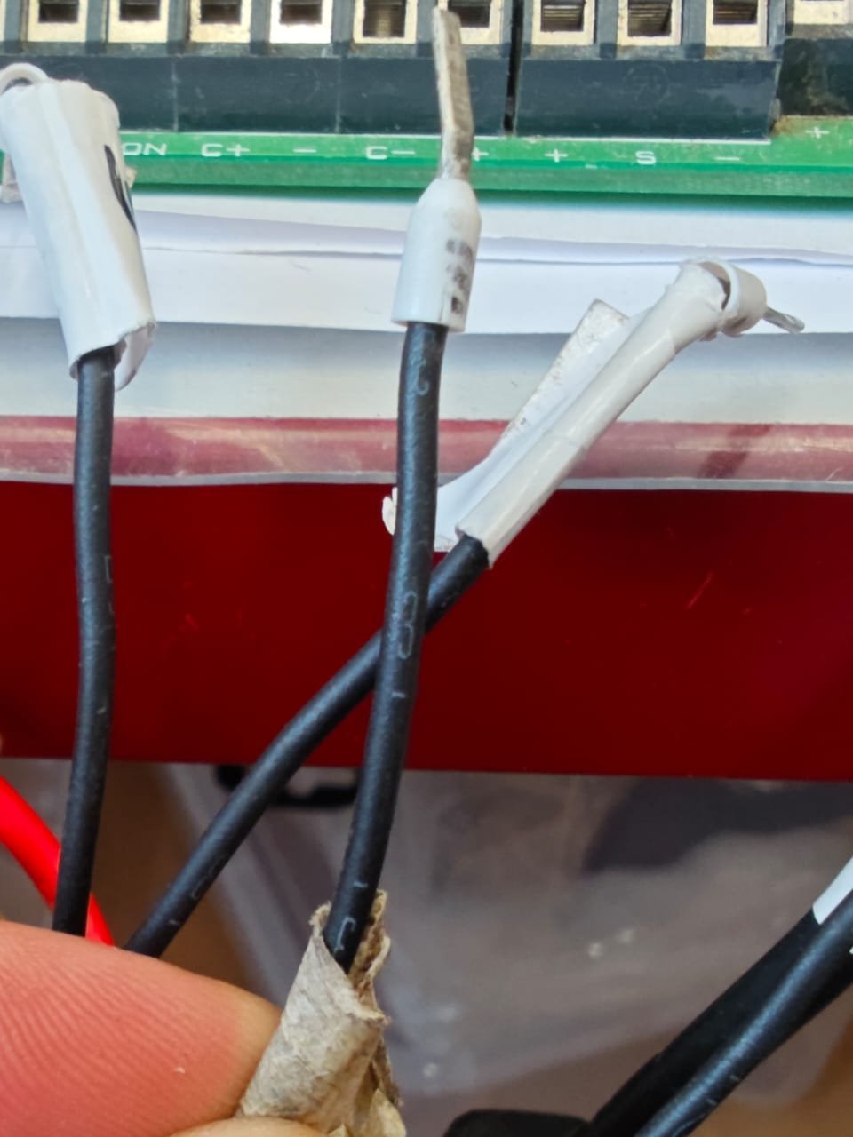

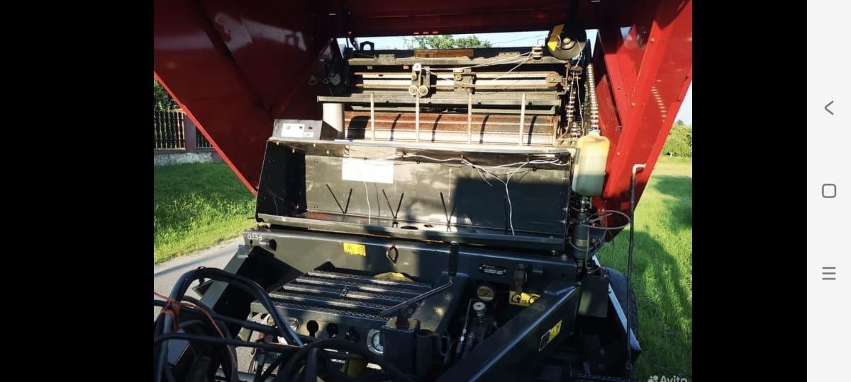

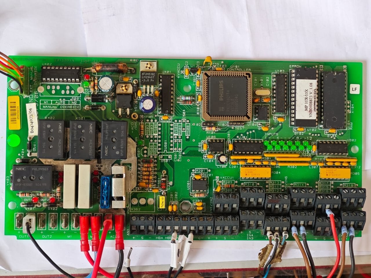

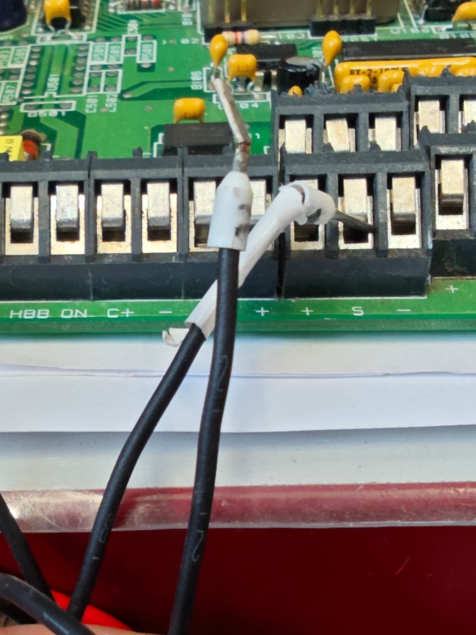

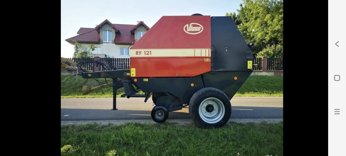

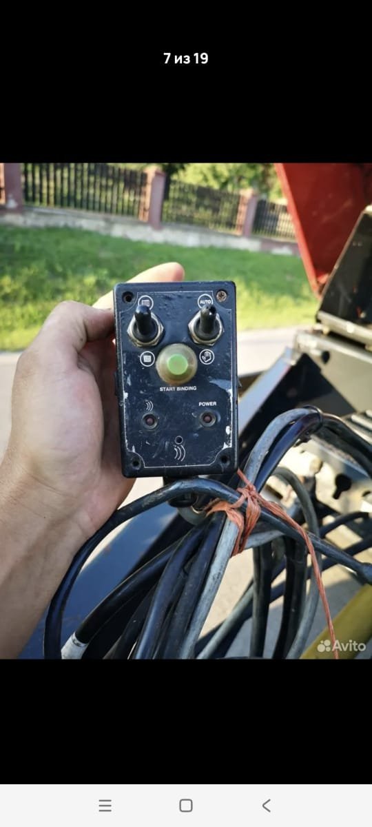

Good afternoon. I need help.
We probably have vicon rf 121
We need your help in pinout and connecting the remote control to the electronic board.
Each wire has a number with a designation
We don't know how to connect each wire correctly. The instructions don't have this information.
