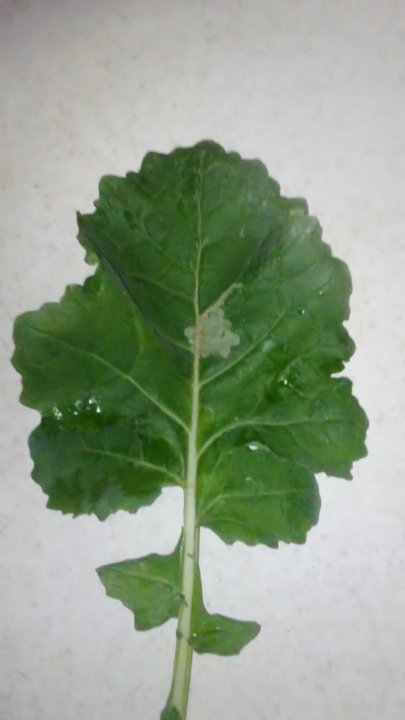

Miniarka kapuściana
Alfazot 025 EC, Bulldock 025 EC, Golden Alpha 100 EC, Rodan 400 EC, Fastac 100 EC, Karate Zeon 050 CS, Fury 100 EW, Ammo Super 100, EW Decis 2,5 EC, Nurelle D 550 EC, Talstar 100 EC, Ripcord Super 050 EC i Cyperkill Super 25 EC.
